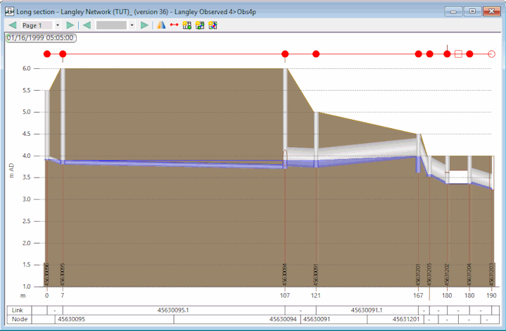

The effect of a rainfall event can be viewed for a particular run of pipes or a specific node by replaying the simulation in the Long Section view.
To illustrate how to view results in the Long Section view, we will use the 'Obs4p' simulation (not the rainfall event of the same name) within the 'Langley Observed 4' Run Group.

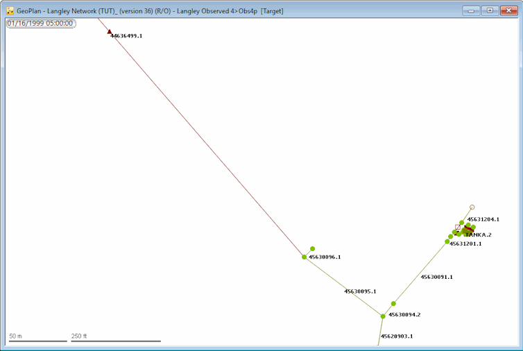

- Use the GeoPlan tools
(Zoom in) and
(Pan) buttons on the
toolbar to zoom into and display the part of the network containing the pump (link '44636499.1', represented by a brown triangle) and outfall (node '45631203', represented by a circle). Alternatively, search for the node or link using the
(Find in GeoPlan) toolbar tool.

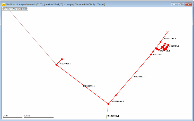

- Locate node '45630095' on the North East side of the network (to the south of the pump) and select all the pipes leading to the outfall ('45631203') node. You can use the selection tool (
) while holding the Ctrl key to select multiple objects.
- Once selected, click the
(Long section) tool to display the selected area in the Long Section view.

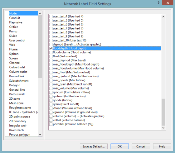

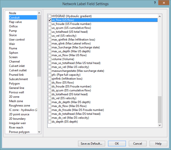

- In the Content tab, click the Field Settings button. The Network Label Field Settings dialog is displayed.
- For this example, select the following parameters from this dialog:
- flooddepth (Do not select flood_depth_1 or flood_depth_2) for Node
- us_flow for Conduit
- Click OK in both the dialogs to close the windows.

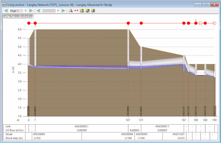

- Click the
button to play the simulation. As the replay progresses you will be able to see the water level changing in the Long Section view. You can run the simulation and pause it at a specific time to observe values at that particular time.

If you zoom in on the block of symbols near the outfall, you will see that it consists of a group of nodes, weirs and an orifice.
The labels are now shown in the boxes at the bottom of the Long Section view:
