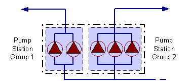

For example, pumps in a pumping station may be grouped in Pump Station Groups according to supply area. Total flow, cost and power results are calculated for each Pump Station Group, by summing the results of the individual Pump Station objects.
Pump Station Groups in a Pumping Station
