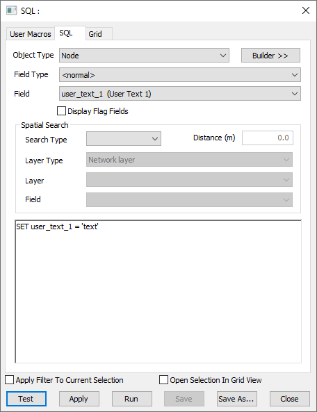

Using the SET keyword
SET <assignment>
For example,
SET user_text_1 = "text"
sets user_text_1 field to text for all objects of the chosen object type (selected in the Object Type field of the SQL dialog).

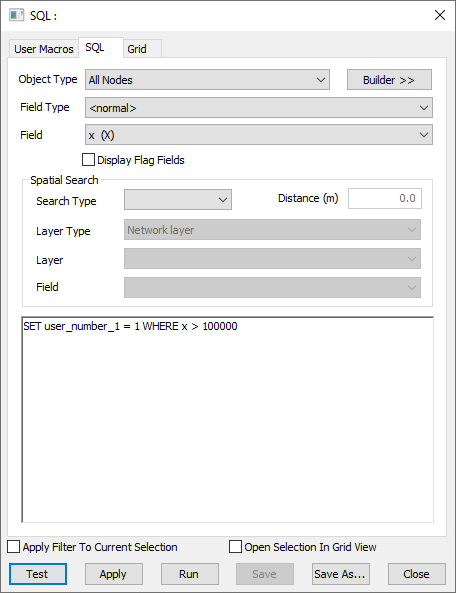

Using SET and WHERE
SET <assignment> WHERE <conditional expression>
For example,
SET user_number_1 = 1 WHERE x > 100000
sets user_number_1 field to 1 for all objects of the chosen object type with x coordinate greater than 100000.

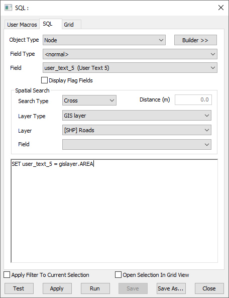

Example 2
This will set the User Text 5 field of any nodes inside a GIS polygon in the GIS Layer "Region" to the value in the "Category" field of the GIS polygon.
See Including GIS data in SQL queries for more information on including GIS Layers in SQL queries.
