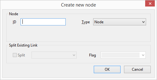

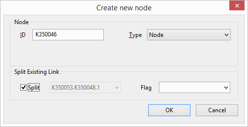

  • The Create New Node dialog is displayed.
  • On the Create New Node dialog, enter a unique node ID. The node ID will be automatically populated if Automatic Node Name Generation is switched on.
  • If inserting a node into an existing link, check the Split box, select the link to be split (if there is more than one), and set a flag for new link lengths (if required).
  • Click OK.
  • The new node is created and displayed on the GeoPlan, and the property sheet for the node is displayed. You can enter additional properties on the Node property sheet now or later. If you change any node properties, click OK to save them.

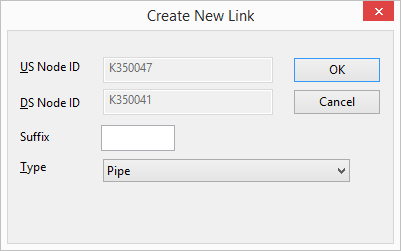

  • The Create New Link dialog is displayed.
  • Select the link type and enter a suffix if necessary. If you do not enter a suffix, InfoWorks WS Pro will create one for you.
  • Click OK.
  • The new link is created and displayed on the GeoPlan, and the property sheet for the new link is displayed. You can enter additional properties now or later. If you change any link properties, click OK to save them. You can click Cancel to exit the property sheet without making any changes. The new link will not be removed.

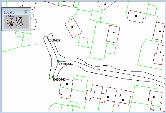

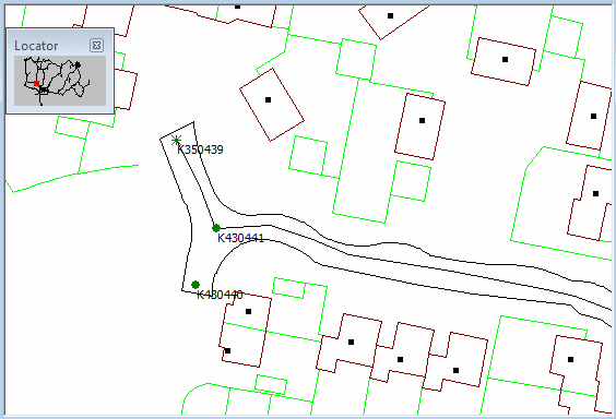

  4. Add a node at the end of the road:
    • Select the New Node (New node) tool.
    • Click in the centre of the road. The Create New Node dialog is displayed.
    • Enter K430440 as the ID and click OK. The Node properties dialog is displayed.
      Node Properties
    • Insert a node in link K350439.K350430.1 , where the pipe bends. Ensure that the Split checkbox is ticked. Name the new node K430441 and click OK.
    • The Node property sheet is displayed.
      Added Nodes

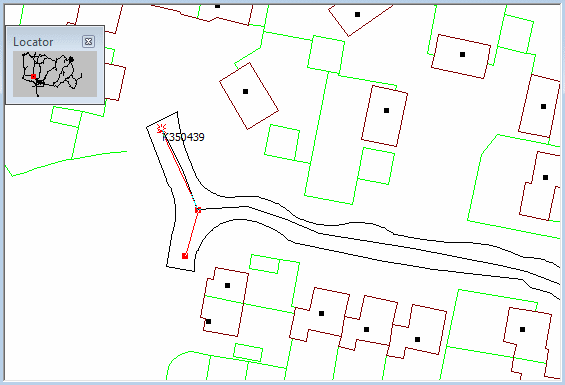

  5. Connect up the nodes:
    • Select the New Link (New link) tool.
    • Click the starting point (the node at the start of the run, new node K430440).
    • Click the road halfway between the nodes to create a bend.
    • Click the node at the end of the link (K350441).

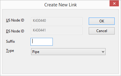

    • Click OK. The Pipe properties dialog is displayed. The suffix is allocated by InfoWorks WS Pro, unless you specify it yourself.
    • Click OK to accept the default pipe properties and close the property sheet.
