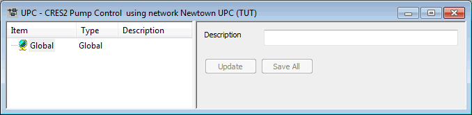

  3. Open the scenario:
    • Right-click CRES2 Pump Control and select Open (or drag the icon onto the window background). The UPC dialog is displayed.
      UPC Dialog

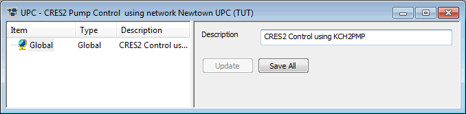

    • Type a description of the scenario in the box on the right and click Update.
      UPC Update

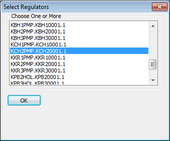

    • Right-click the Global item on the left of the dialog and select Insert regulator.
    • From the list of potential regulators, choose KCH2PMP.KCH20001.1.
      Selecting Regulators

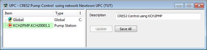

    • The pump is added to the list on the left of the dialog. Drag the boundaries between the column headers so that you can see the full details in the item list.
      Pump added

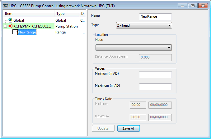

    • Right-click the KCH2PMP item and select Insert dependent | Range. The new range is added below the pump (expand the list to see it) and its details can be inserted in the right-hand pane.
      Adding a new range

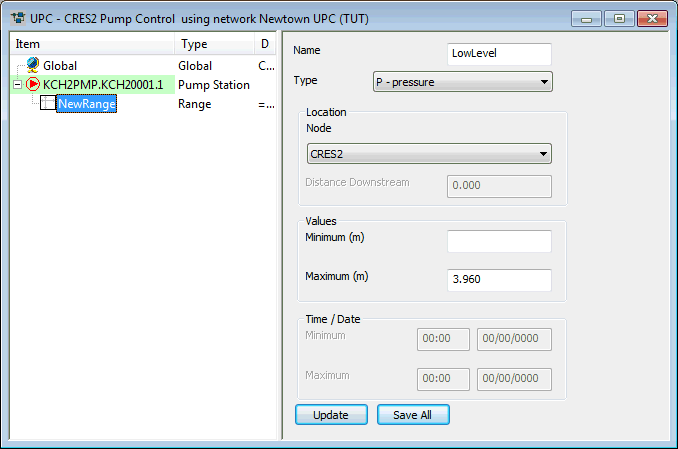

    • Enter a Name of 'LowLevel' and Type of 'P - pressure', select CRES2 as the Node and enter a value of 3.96 m as the Maximum.
      Specifying the range
    • Click Update. The entry on the left is updated with the new details. You can change the size of the UPC dialog by dragging its edges.

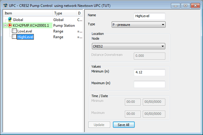

    • Right-click the KCH2PMP item again and add a second range (Insert dependent | Range). Give this a Name of 'HighLevel', Type 'P - pressure', Node CRES2 and Minimum of 4.12 m. Click Update. The Description field for the range contains the details that were specified; this is generated by the system. You can view the full description by placing the mouse pointer over it; alternatively, drag the divider between the two panes to make the left-hand pane wider.
      Adding a second range

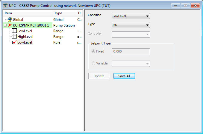

    • Right-click the KCH2PMP item and select Insert dependent | Rule.
    • For the Condition, select LowLevel from the drop-down list.
    • For the Type, select ON. This rule specifies that when the LowLevel condition is satisfied, the regulator (KCH2PMP) is switched on. The LowLevel condition is satisfied when the level in the reservoir is on or below 3.96 m.
    • Click Update.
      Adding a new rule

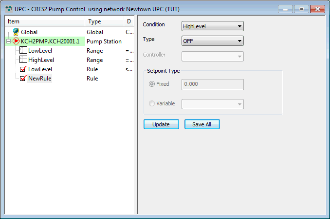

    • Add a second rule with Condition HighLevel and Type OFF. This rule specifies that when the level in the reservoir is on or above 4.12 m the pump is switched off.
      Adding a second rule
    • Click Update.

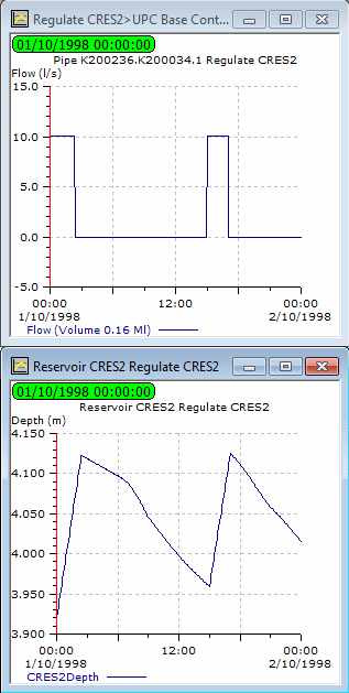

    • Use the Graph (Graph) button to display a graph of flow for K200236.K200034.1 and depth for CRES2.
    • Minimise the GeoPlan.
    • Tile the views horizontally. The graphs show that the pump is switched on and off when the level in the reservoir reaches the specified levels, in a similar way to the original level control.
      Graphs tiled horizontally
