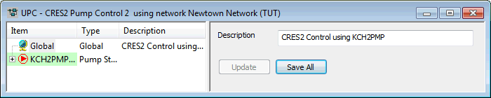

- Right-click 'CRES2 Pump Control 2' and select Open (or drag the icon onto the window background). The UPC dialog is displayed,
- Click the

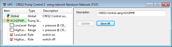

button to the left of the KCH2PMP regulator entry to display its dependents, then adjust the column widths so that you can read the text.

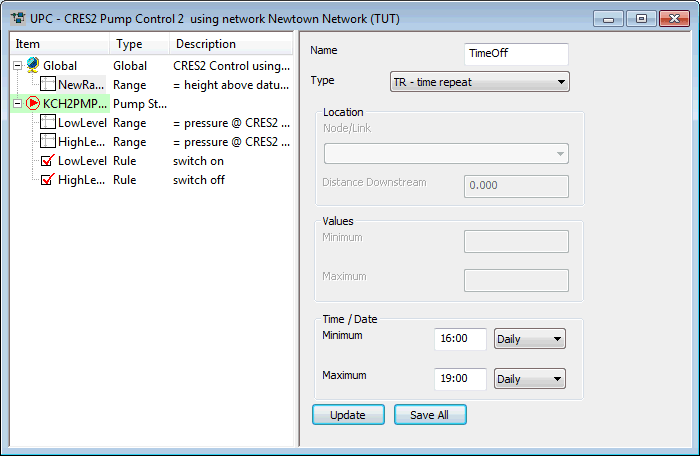

- Add a global range (which can be used by any regulator):
- Right-click the Global item and select Insert dependent | Range.
- Expand the list to see the new range, then select it.
- In the right panel, enter a Name of 'TimeOff' and Type of 'TR - time repeat'.
- Enter '16:00' as the Minimum and '19:00' as the
Maximum. In each case, select 'Daily' from the drop-down list. This range will be applied each day that the simulation is run.
- Click Update. The entry on the left is updated with the new details.

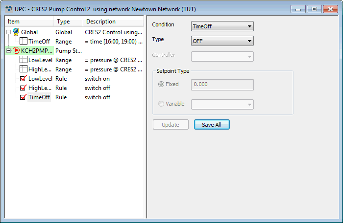

- Add the new rule for the regulator:
- Right-click the KCH2PMP item and select Insert dependent | Rule.
- For the Condition, select TimeOff from the drop-down list.
- For the Type, select OFF. This rule specifies that when the TimeOff condition is satisfied, the regulator (KCH2PMP) is switched off. The TimeOff condition is satisfied when the time is between 4 pm and 7 pm.
- Click
Update.

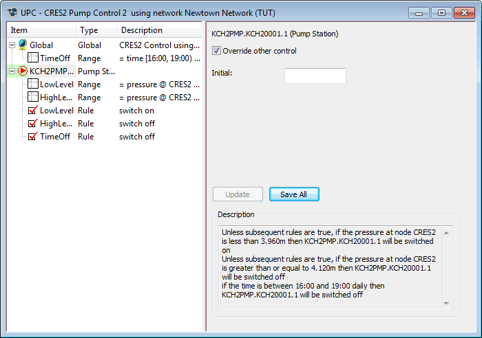

- Inspect the scenario:
- Click any item in the list to view or edit its definition.
- Click the regulator to specify whether the rules override any controls in the network and to give it an initial value. The full description of the regulator is shown in the box at the bottom of the right-hand pane.

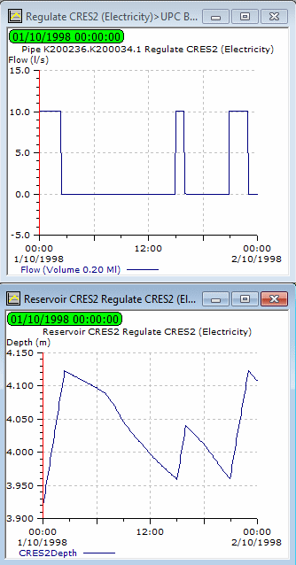

- View the simulation results:
- Open the simulation from the 'Regulate CRES2 (Electricity)' run.
- Use the
(Graph) button to display a graph of flow for K200236.K200034.1 and depth for CRES2.
- Minimise the GeoPlan.
- Tile the views horizontally. The pump now switches off at 4 o'clock and stays off during the peak period. At the end of the period it is switched on again until the level in the reservoir reaches the required level.
