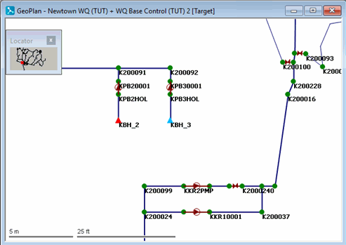

- Associate the new control branch with the network and zoom in on the area around borehole KBH_2.
- Change the water quality parameters at the borehole:
- Select the
(Properties) tool and click KBH_2 to display the borehole's properties.

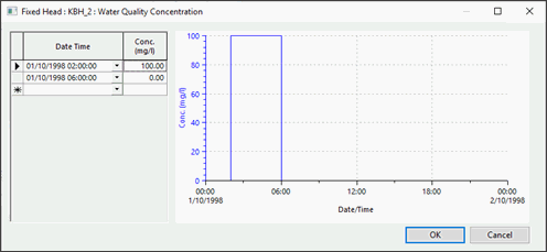

- For the Water Quality Concentration property, set the date and time in the first row of the Date Time column to 01/10/1998 02:00, and against it enter a concentration of 100 mg/l.
- On the next line, set the date and time to 01/10/1998 06:00 and enter a concentration of 0 mg/l.
Ticking the Linear WQ Profile box interpolates the concentration between data points.
- Click OK.

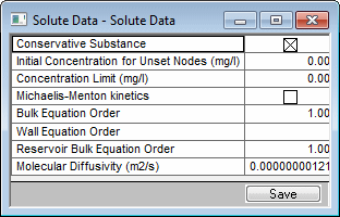

- Create a new Solute Data item:
- Right-click the Solute Data Group and select New | Solute data.
- Accept the default name.
- Drag the new item onto the InfoWorks background or right-click to open the Solute Data dialog.
- Select the
Conservative Substance.
If the Conservative Substance box is selected, the substance is a conservative substance. Conservative substances are only affected by transport within the network. There is no reaction with the network environment and no decay.
- Close the Solute Data dialog and save the changes.

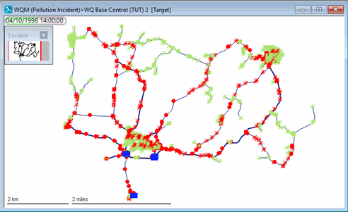

- Use a theme to demonstrate the effect of the pollution incident over the network as a whole:
- Open the simulation from the 'WQM Test (Pollution Incident)' run.
- Display the whole network and turn off the Locator window.
- On the GeoPlan Properties And Themes dialog, open the layer theme editor for the Node object layer (by clicking Edit in the Theme column).
- Create a new sub theme and name it Pollution Incident.
- Choose the sim.CONC01 field to show the concentration throughout the network. This is available only if there are simulations.
- In the Ranged Themes area, increase the value count to 11.
- For the eleventh value, show the cross in the Fix column, then set the value to 1 and click AutoScale.
- Click OK on the layer theme editor and on the GeoPlan Properties And Themes dialog.
- Replay the simulation. The pollution spreads through the network over a period of days, eventually clearing from the borehole outwards.

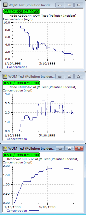

- Display graphs of various locations to illustrate the way in which the pollution spreads:
- Identify nodes K350144 and K400542, and reservoir KRES32.
- Use the
(Graph) button to display a graph of Concentration in each case.
- Turn off the theme and close the GeoPlan view.
