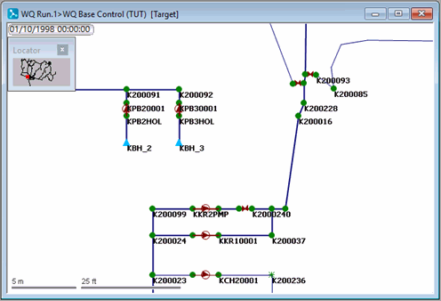

  1. Display the simulation in the GeoPlan view:
    • Open the 'WQ Base Control_1' from the 'WQ Run1' Run Group.
    • Zoom in on the borehole.
      Zoomed in Network

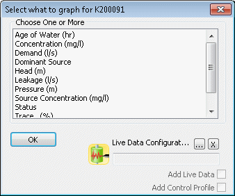

    • Use the Graph (Graph) button to select a graph for K200091. There are now additional parameters to choose from: Concentration, Trace, Age of Water, Dominant Source and Source Concentration.

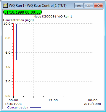

    • Select the Concentration graph. This displays the concentration of the chemical at the node over the period of the simulation. For this node, which is very close to the borehole, the full concentration arrives at the node almost immediately.

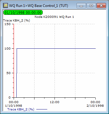

    • Select the Trace graph. This displays the proportion of water received from the trace node (KBH_2) at any time. The graph shows that all water passing through the node is from the trace node after about 50 minutes.

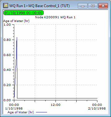

    • Select the Age of Water graph. This displays the age of the water at the selected node (i.e. the time taken to travel to the node from the trace node). The peaks in the graph correspond to the times when the pump for the borehole was switched on.
      Age of Water graph

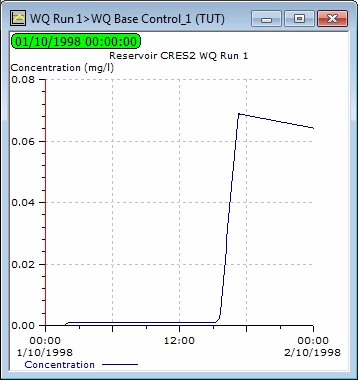

  3. Produce similar graphs for the reservoir CRES2:
    • Right-click the GeoPlan and select Find Network, then zoom in on the reservoir. You can zoom in on an area by holding down the Shift key and then dragging the pointer over a part of the network, without having to change the tool you are using.
    • Select the Concentration graph. This shows that it takes some hours for the initial concentration to reach the reservoir. The concentration increases until the pump is switched off, following which it decays until the pump is switched on again.
      Reservoir Concentration Graph

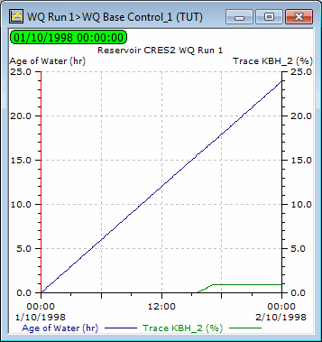

    • Select the Trace and Age of Water together on a single graph. This shows the proportion of water from the trace node and the time taken to reach the reservoir.

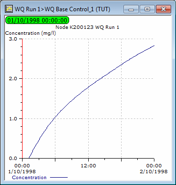

    • Identify node K200123.
    • Display the graph for Concentration. This shows that the water from KBH_2 takes much longer to reach this node and the concentration is much lower.

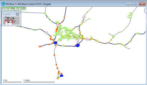

  5. Use a theme to demonstrate the effect over the network as a whole of adding the chemical:
    • Display the whole network and turn off the Locator window.
    • On the GeoPlan Properties And Themes dialog, open the layer theme editor for the Node object layer (by clicking Edit in the Theme column).
    • Create a new sub theme and name it Concentration.
    • Choose the sim.CONC01 field to show the concentration throughout the network. This is available only if there are simulations.
    • In the Ranged Themes area, increase the value count to 11.
    • For the eleventh value, show the cross in the Fix column, then set the value to 1 and click AutoScale.
    • Click OK on the layer theme editor and on the GeoPlan Properties And Themes dialog.
    • Replay the simulation. The changing colour of the nodes illustrates the spread of the chemical through the network.
      Theme on GeoPlan
    • Turn off the theme and close the GeoPlan view.
