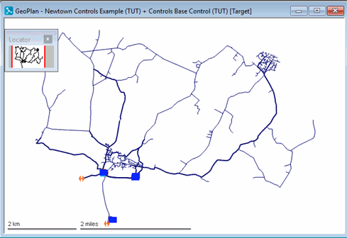

The network contains a number of pumping stations for pumping from boreholes. In particular, a pair of pumping stations (KBH1PMP and KBH2PMP) pump to a demand at K200029 and nodes to the south. One of these pumps is on for 24 hours, while the other is permanently off. You can change the pumping times so that the duty is split equally between them.
To change the pump controls:
- Open the Newtown Controls Example network.
- Open the Controls Base Control icon and associate it with the network to edit it.

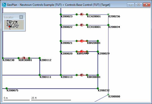

- Zoom in on KBH1PMP.KBH10001.1 and KBH2PMP.KBH20001.1.

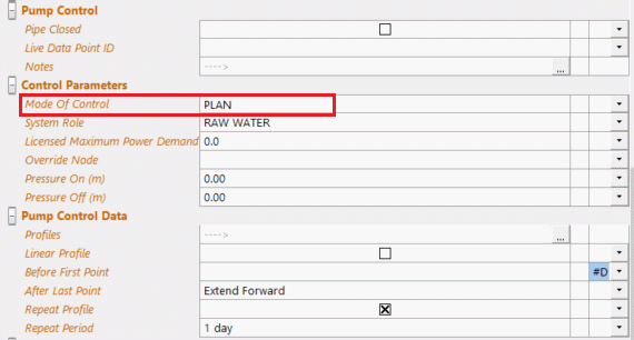

- In the Pump Control section, the
Mode of Control is shown as PLAN in each case. This mode allows you to set the pumping times for the pump.
- The Pump Control Data section shows the initial status of the pump and the time at which the pump is switched on or off. Opening the Profiles property shows the Pump Status Flag is 0 when the pump is being switched off, or 1 when it is switched on. Currently, the pump at KBH1PMP is permanently on and KBH2PMP is off.

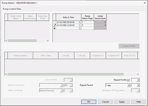

- Select the
(Properties) tool and click the pump at KBH2PMP.
- Open the Control Data properties, leave the value of "01/01/1998 00:00" in the top row of the Date & Time column (the date and time at which the pump status is to change).
- Enter a value of 1 for the Pump Status Flag on the right.
- Leave the values in the second row ("01/01/1998 12:00" and pump status flag set to 0).
- Display the properties for the pump at KBH1PMP. Open the Control Data sheet.
- For a date and time of "01/01/1998 00:00", set the flag to 0; for "01/01/1998 12:00", leave the flag as 1.

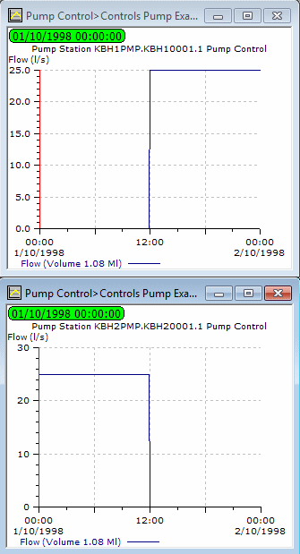

- When the simulation is complete, click the
(Close dialog) button.
- View the simulation results:
- Open the simulation from the 'Pump Control' run.
- Use the
button to display graphs of flow for the pipes out of the pumping stations.
- Minimise the GeoPlan.
- Tile the views horizontally.
The views show that KBH2PMP is on for the first half of the day and KBH1PMP is on for the second half.
