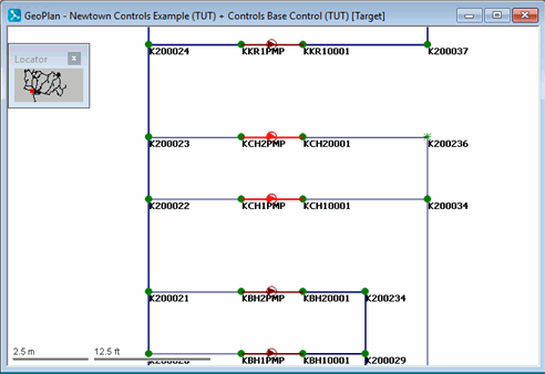

- Zoom in on KCH1PMP.KCH10001.1 and KCH2PMP.KCH20001.1.

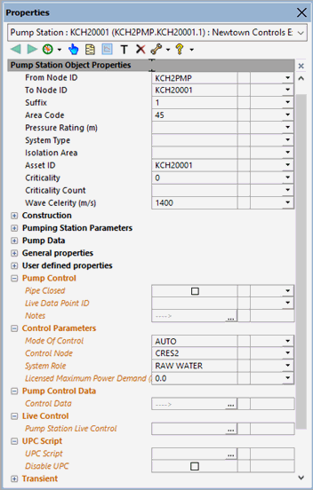

- Display the properties for the pumps:
- In the Control Parameters section, the
Mode of Control is shown as AUTO in each case. In this mode, pump status is set according to the level recorded at a node (in this case, the reservoir, CRES2).

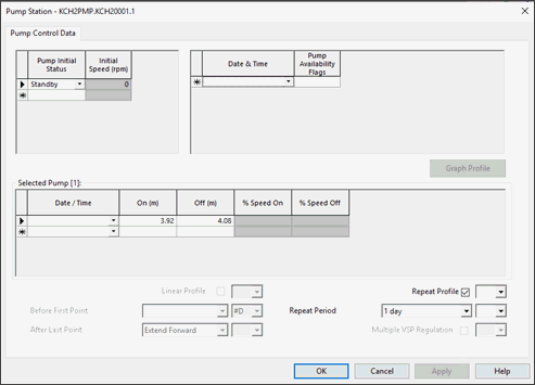

- The Pump Control Data section shows the initial status of the pump. For KCH2PMP, the
Pump Initial Status is shown as 'Standby', indicating that the pump is available but initially switched off; the reservoir levels at which the pump is switched on and off are given as 3.92 m and 4.08 m. For KCH1PMP, the status is 'Not Available'.

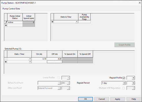

- Change the properties in the Pump Control Data section so that KCH1PMP is the duty pump and initially on, and KCH2PMP is the standby pump (that is, not available):
- For KCH2PMP, change the Pump Initial Status to 'Not Available'.
- For KCH1PMP, change the
Pump Initial Status to 'Active'; change the
On value to 3.70 m and
Off to 4.00 m. This widens the operating range for the pump.

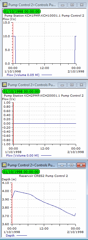

- View the simulation results:
- Open the simulation from the 'Pump Control 2' run.
- Use the
(Graph) button to display graphs of flow out of the pumping stations and a graph of depth for the reservoir.
- Minimise the GeoPlan.
- Tile the views horizontally.
Originally, both pumps were off and the reservoir level dropped until the depth was 3.92 m. Now, the views show that KCH1PMP is on initially, turning off when the reservoir level reaches 4.00 m and back on again when it drops to 3.70 m. KCH1PMP is permanently off.
