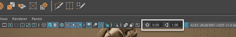

Exposure and Gamma support for Playblasted animation
You can now control the gamma and exposure levels on a Playblast.
Gamma and Exposure settings in the Panel Toolbar

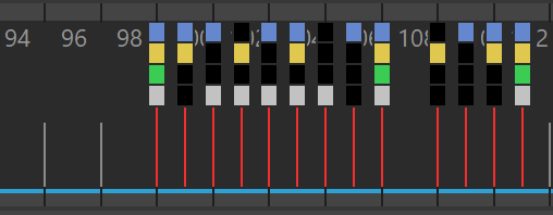

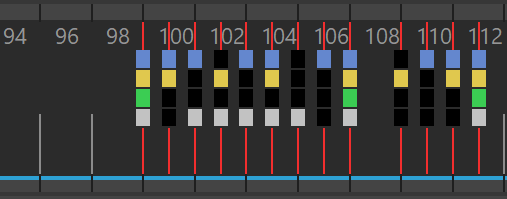

Time Slider Color Coded Key update
Before: Frame numbers hidden by Color Coded keys
Now: Color Coded keys appear below key numbers
