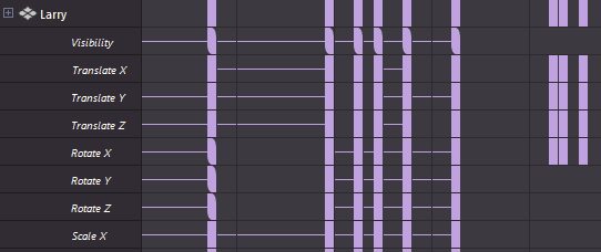

Dope Sheet Editor Selection Improvements
This update includes several enhancements to key selection, which are useful because the specialty of the Dope Sheet Editor is working with dense keyframes and large-scale timing edits:

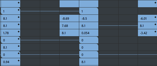

Shift-Select to update multiple key values
Updating multiple key values at once
- Shift-select multiple Dope Sheet Editor keys.
- While holding Shift, double-click one of the selected keys and enter a value to modify them all at once.

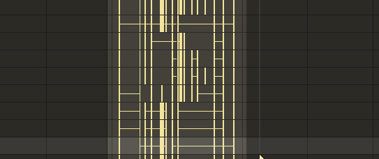

Improved selection of dense keys
Left: Selecting dense keys in Maya 2025, Right: new in 2025.1, frame numbers display
Improvements to the
Dope Sheet
Edit >
Transformation Tools >
Select Keys
tool let you work with more precision in areas where there are many keys crowded tightly together. Now, frame numbers appear over each corner of the selection to give you the precise location of the selected keys.
Working with the
Select Keys tool
is also now easier to see and manipulate, and a problem where the displayed end frame number was shown at an offset from the actual selection has been addressed. These improvements are a particular help when working with a dense number of keys.

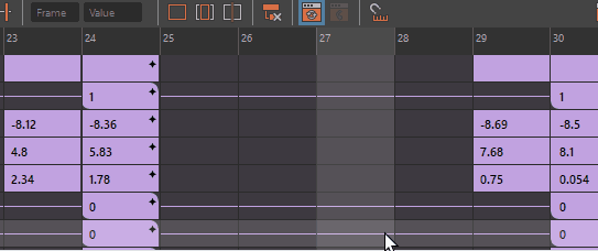

Disable snapping with Time Snap
Moving a key with the Time Snap option
A new Time Snap option has been added to the Dope Sheet toolbar to let you activate or disable snapping. Similar to the Graph Editor Time Snap option, it forces keys moved in the View area to the nearest integer (nonfractional) time unit value.
