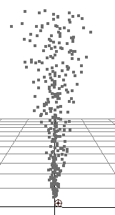

Example
An emitter shoots particles up in a 150-frame animation. The following steps show how to control the velocity of the particles by keying Current Time.
- Select the emitted particle object (not the emitter).
- In the Channel Box, click the Current Time attribute, then right-click and select Break Connections.
- Set keys for Current Time at the following frames:
Frame Current Time 0
0
50
100
100
110
150
200
At the beginning of the animation (frame 0), the Current Time of the emitted particles is synchronized with the scene time. Both have the value 0.
At frame 50, the Current Time is keyed to 100, twice the value of the scene time. For frames 0 through 50, this adds twice as much time to the action of the emitted particles as the scene time. The emitted particles therefore move at twice the speed that would occur without the manipulation of the Current Time.
At frame 100, Current Time is keyed to 110. From frames 50 to 100, this slows the progression of time for the emitted particles relative to the scene time. The emitted particles move at a slower speed than would exist without the manipulation of the Current Time.
At frame 150, Current Time is keyed to 200, once again speeding the progression of time for the emitted particles. The particles move faster again.
