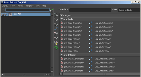

- Open the Asset Editor by selecting Assets > Asset Editor or Window > General Editors > Asset Editor.
- In the left panel of the Asset Editor, select the Car_CNT asset and click the Pin Asset icon
. The published attributes of the asset display in the right panel.

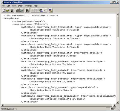

- Create a template for the car asset as follows:
- From the Asset Editor menu bar, select Template > Save As.
A file browser opens to the assets sub-directory of your current project.
- Enter Vehicle in the File name field, and click Save.
The template is saved in the assets sub-directory and the template name now displays at the top of the Asset Editor.
- (Optional) Open the XML template file you have just created using the XML editor of your choice.
The default template lists all of the published attributes in a flat list. In the next steps, you’ll add views and make other edits to this template file to help organize your asset.
- (Optional) Close the XML template file before continuing.

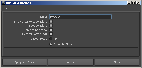

Create a template view
- In the left panel of the Asset Editor, select the car asset and click the Pin Asset icon
(if it is not already pinned). - In the Asset Editor menu bar, select View > Add >
. The Add View Options appear.
- In the Add View Options, keep the default options turned on and enter Modeler as the view Name. Click Apply and Close when finished. (See also Add a view to an asset template.)

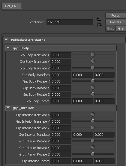

The template switches to use the new view in the right panel of the Asset Editor. The new view is also active in the Attribute Editor.
The asset’s attributes are currently organized using the default Group By Node layout. Each group of attributes displays under a heading based on its parent node name.

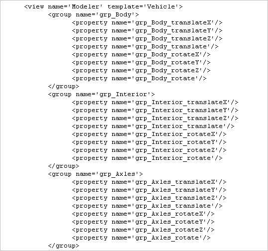

- Open the XML editor of your choice, and navigate to open the XML Vehicle template file.
- Search the XML file for the word Modeler to locate the section of the template file where the Modeler view is defined. (See Parts of an Asset.)
Because the Group By Node option was turned on when you created the Modeler view, all the attributes in the XML file are grouped under “group name” headings.
In the view definition, each published attribute is represented by a property element. The property elements correspond to the published attributes by name.

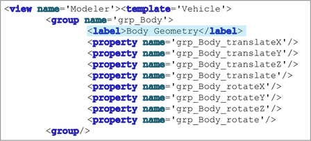

- Customize the view until it is set up for the modeling artist on your team. (See Customize a template view.) For example, you might do the following:

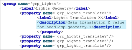

- For each group element, add <label> elements to change the display name for the group in the Attribute Editor.

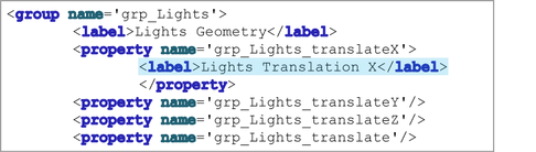

- For each property element, add <label> elements to change the display name of the attribute in this view only. Tip:
When adding elements within a property definition, ensure you delete the existing trailing slash / from the property element and add a closing </property> tag.

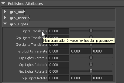

- Add <description> elements to each property definition to create tooltip help.
The description text will appear over each attribute when an asset user hovers the mouse pointer over them in the Attribute Editor.
All of these changes let you completely customize the interface your modeling artist will use when they work with car assets.

- Return to Maya and select Template > Reload in the Asset Editor to reload the template. (See also Reload an asset template.)
The published attributes in the right panel update to reflect the changes you made. The changes are also reflected in other editors, such as the Attribute Editor.
