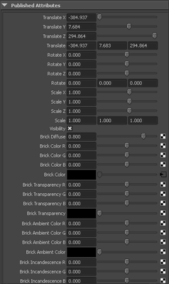

The following image shows the Attribute Editor for an asset with a basic, default template assigned. The asset’s template has not yet been edited.

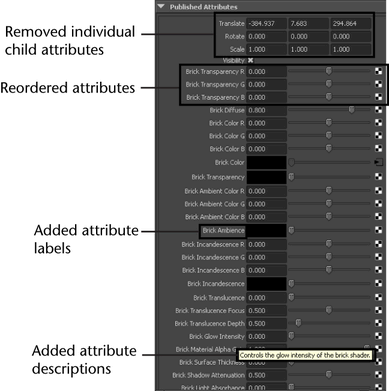

You can edit an asset template file in the XML editor of your choice. (Refer to Parts of an asset template and Template file format for detailed information about template files.) The following image shows the Attribute Editor for the same asset after some simple modifications to its template file.

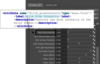

To rename published attribute names in the template
- Edit the name text string within an <attribute> element.
Note:The name for an <attribute> element cannot contain spaces, special characters, or multibyte characters. If you want the display name for an attribute to display with spaces or special characters, you can add <label> elements to contain those names.

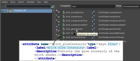

To change the display names for an asset
- Edit the <label> element within an <attribute> definition.
Unlike the attribute names, the <label> elements can contain spaces, special characters, and multibyte characters.
Note:Editing the <label> element also changes the tooltip text that displays over the attribute in the Asset Editor.

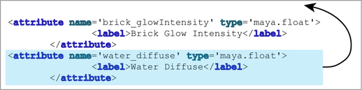

To reorder published attribute names
- Select and cut an entire <attribute> element.
- Paste the element to a new location.
Ensure that you don’t paste the selected attribute element inside another attribute element, as this structure will not validate.
To remove published attribute names from the template
- Delete entire <attribute> elements.

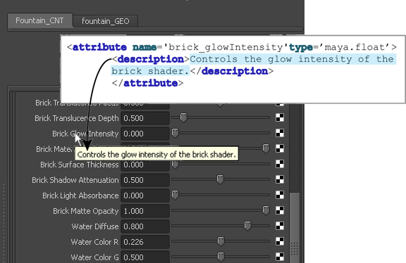

To change the tooltips that display over published names in the Attribute Editor
- Edit the text within an attribute’s <description> element. Tip:
The text within <description> tags can be localized. See Localize the asset user interface.
