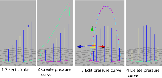

In the following example, Tube Length is mapped to pressure for the stroke. A pressure curve for the stroke was edited to produce new pressure values, and therefore new tube lengths.

  1. In the scene view, select the stroke.
  2. Create the pressure curve as follows:
    • Select Generate > Curve Utilities > Make Pressure Curve > . The Make Pressure Curve Options window appears.
    • Set the number of control points you want along the pressure curve. The more control points, the smoother the transition between pressure points. Pressure points in between these points are linearly interpolated.
    • Set how far the pressure curve should be offset from the stroke. This has no effect on the pressure values, it just controls the position of the pressure curve, so you can set the scale according to your scene.
    • Click Create. Paint Effects creates the pressure curve on top of the stroke, then offsets the curve in a direction normal to the curve, based on the pressure values multiplied by the offset scale.
    An expression is also created when you create the curve.
  3. Edit the pressure curve as follows:
    • Select the stroke, right-click to open the marking menu, then select Control Vertex to enter CV selection mode.
    • Select CVs on the pressure curve and translate them to new pressure values. The distance of the pressure curve from the stroke in 3D affects the pressure values.
  4. When you are satisfied with the new pressure values, you can delete the pressure curve. It is no longer needed.
