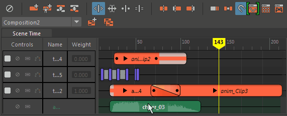

- Once you have populated the selected scene objects in the Time Editor, turn on
Mute/Unmute the Time Editor
in the
Time Editor toolbar. A
appears over the Time View to signal that the
Time Editor is temporarily disabled.
- Make changes outside of the Time Editor window to author new animation, apply constraints, create expressions, and so on.
- When you are done, from the Time Editor menu, click
again.
