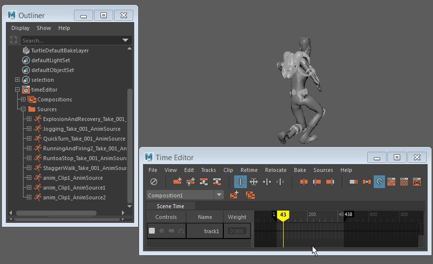

No animation Source
You need an animation source to drive objects in the Time Editor. You can see what animation sources are in your scene in the Time Editor Source menu and the Outliner. These contain a library of the animation sources in the current scene. If you have a clip that is not driven by anything, middle-mouse-drag an animation source from the Outliner onto a clip.
See Create clips from Animation Sources and Time Editor Animation Sources for more information.
