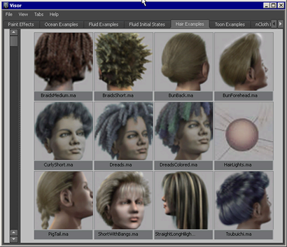

To import a Hair preset into a scene
- In the FX menu set, select . The Content Browser opens to the Hair Examples tab.
- Middle-drag the desired Hair preset from the
Content Browser into the scene to import the hair system and its surface. See
To transplant a Hair Preset to another surface.
The Notes section at the bottom of the Attribute Editor provides information about the Hair preset, pointing out the key aspects of its construction.
