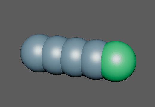

For example, when you perform an intersection operation on the following list of objects, it returns an empty result and an error message:
If you want to run an intersection on a list of objects, you can try the following:
  1. Manually perform a union operation.
    In the following example, the first four input objects are selected and fused together.
  2. Perform an intersection operation using the last input object.
