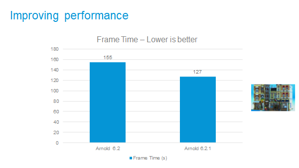

  • Toon shader (contour_filter) optimizations: The toon shader has been optimized, especially for Windows machines with many cores and many small buckets, wherein in some situations we've seen over a 4x speedup (core#10414, #10242).

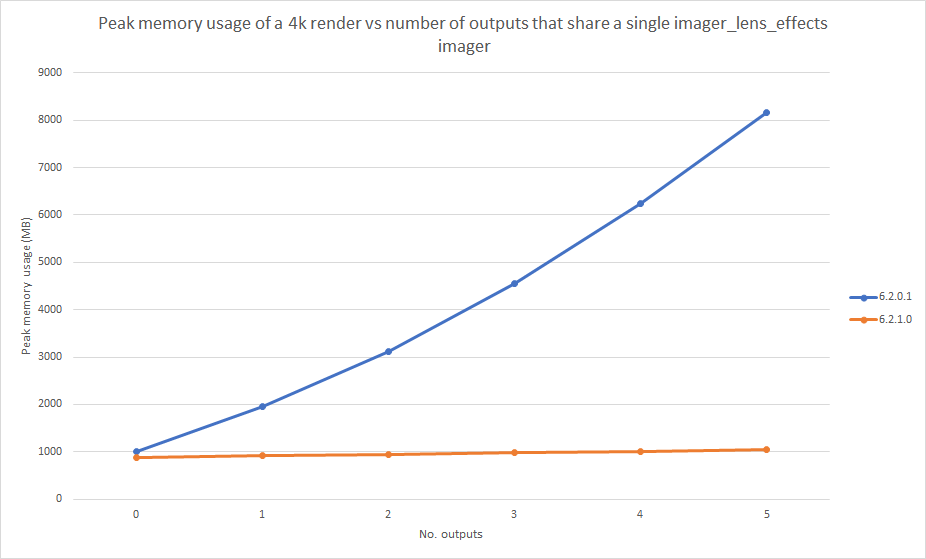

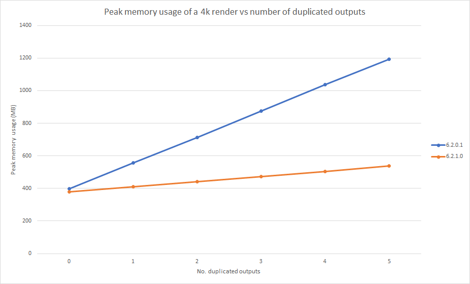

  • Improved output memory usage: The memory usage of outputs has been improved in a variety of cases. If a single output is sent to multiple drivers the memory is now shared, rather than duplicated (see the first graph below). The memory gains are even more substantial when imagers chains are shared between drivers. Again previously this would lead to much-duplicated memory that is now shared (see second graph below). (core#10214)

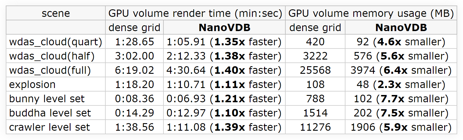

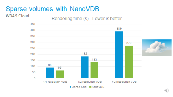

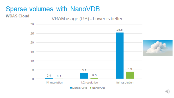

  • Sparse volumes on GPU : VDB volumes are now loaded on GPU in a sparse form using NVIDIA's NanoVDB library. This can lead to a very significant reduction in GPU memory usage in scenes with volumes, depending on the volume sparsity, compared to the previous dense grid implementation, as shown in the table below. This also produced a speedup due to the faster skipping of empty space possible with NanoVDB. (core#9626, core#10333).

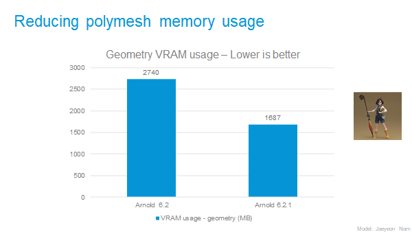

  • Reduced VRAM use for polymeshes : The amount of VRAM used by polymesh is significantly lower in this version. Scenes with heavy subdivisions will use around 33% less GPU memory for geometry (core#10462).
