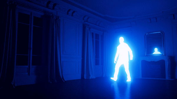

Light Mixer imager : This new imager makes it possible to interactively edit the contribution of light group AOVs during and after rendering without restarting the render (core#9838).

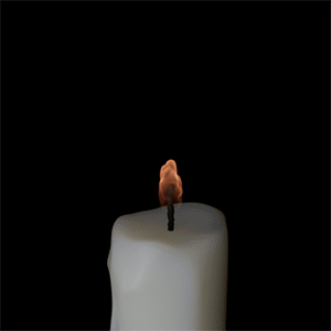

Bloom in imager_lens_effect : The imager_lens_effect now implements a bloom effect. Bloom or glow is a post-processing effect that will blur pixels above a given threshold across the frame to simulate light bleeding on an imperfect lens. See the (core#9728).
Noice denoiser imager : The Arnold Noice denoiser is now also available as a post-processing effect. You can automatically denoise images every time you render a scene, edit the denoising settings and see the resulting image directly in the render view. Note that imager_denoiser_noice does not support temporal denoising (core#9718).
OptiX denoiser imager : The OptiX™ denoiser is now available as a post-processing effect. The imager also exposes additional controls for clamping and blending the result. (core#9719).
