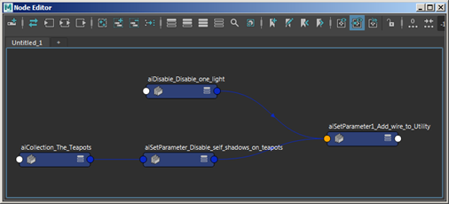

This short tutorial will cover how to use the set_parameter, collection, and disable operators to change the lights and self-shadowing of some teapots and alter the shading of the sphere. The scene contains two lights casting shadows on three teapots and a sphere with a simple utility shader assigned to it.

Collection
We will use the Collection operator to reference a selection. This can be used to avoid writing a selection multiple times (optional in this case).
  • Create a collection operator containing two teapots. Under selection add the following (we will apply a set_parameter that will only affect these two teapots):
Teapot001Shape or Teapot002Shape
Teapot Collection
Set Parameter (Disable Self Shadows on the Teapots)
  • Create a set_parameter. Create the following expression:
self_shadows=false
Disable Light
We can turn off one of the lights by using the Disable operator.
  • Create a Disable operator and under Selection enter for the following Arnold light:
ArnoldLight001 disabled
Set Parameter: Sphere Utility Shader
Now we will change the overlay_mode for the spheres utility shader.
  • Assign a utility shader to the sphere and rename it to the_utility.
  • Create another set_parameter and under expression enter the following:
overlay_mode="wire"
  • Under selection enter the following:
Utility shader altered with Set Parameter
Final Operator Graph window setup
