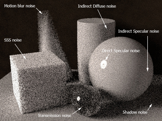

Here is a very noisy scene where all of the samples have been set to 1.
| All samples: 1 | Final sample settings |
Camera (AA) samples: 1
Diffuse samples: 1
Specular samples: 1
Transmission samples: 1
SSS samples: 1
Light samples: 1
The most efficient method for identifying noise is to render AOVs. This can help save time by reducing the need to adjust settings unnecessarily.
AOVs
| diffuse_direct | diffuse_indirect | specular_direct |
| specular_indirect | sss | transmission |
In the examples below the smoother option is shown with samples of 10. This is a very high value and is only used here because the Camera (AA) samples and all other samples are at 1 for an illustrative effect to contrast the noisy and smooth areas. Normally the Camera (AA) samples would be around 4-8, and as it acts as a multiplier, similar values would be needed for the other samples.

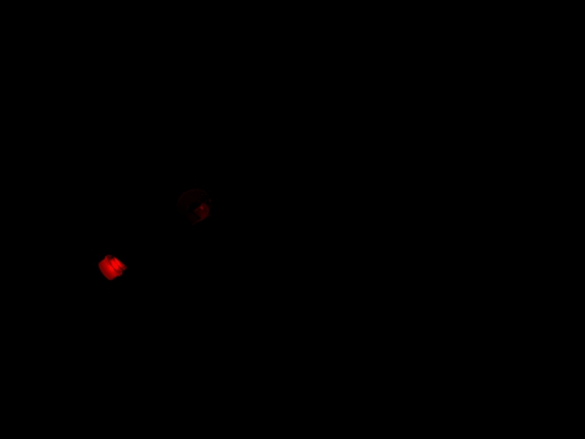

Both the depth of field and motion blur can be confirmed by looking at the alpha channel to see if noise is present.
| Motion blur alpha | Depth of field alpha |
Motion blur and depth of field noise are caused by insufficient camera rays and therefore can only be solved by increasing Camera (AA) samples. The actual number of Camera (AA) samples is the square of this number. Camera (AA) samples of 4 results in 16 rays being cast. Note that increasing Camera (AA) samples will also increase the other samples meaning that they should be decreased to compensate.

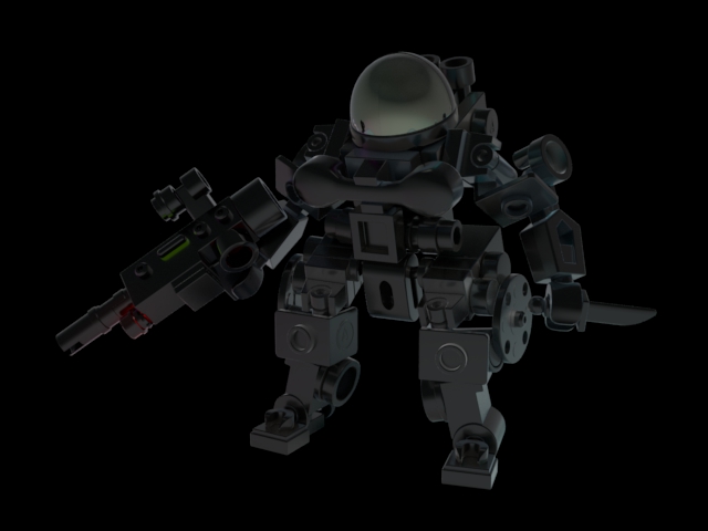

Transmission noise is noticeable in the blurred refraction of a transparent object when specular_roughness > 0. The easiest way to confirm this is to check the transmission AOV. Another method is to set transmission samples to 0 which will remove blurred refractions. If the noise disappears, then it is created by transmission.
Transmission noise is caused by a lack of transmission samples. Transmission samples c ontrol the number of samples used to simulate the microfacet-based glossy refraction evaluations. The exact number of rays is the square of this value. Increase this number to reduce noise in shaders using transmission.
