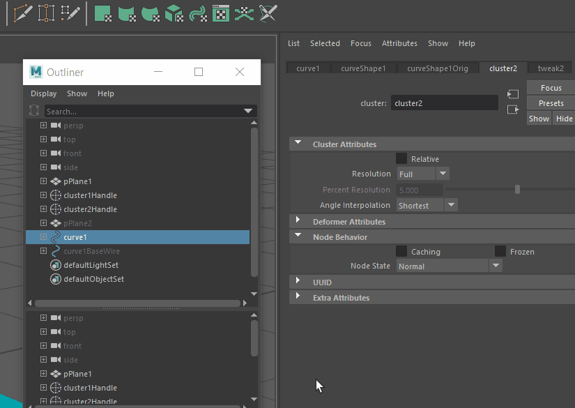

- To dock or undock a floating window, drag it by the title bar to the location you want. Once the window is over a valid location, the join area highlights in blue and the window becomes transparent. Release the window in the new position.
- To dock a window as a new panel, drop it onto a vertical or horizontal edge next to or between existing panels.
- To add a window as a new
tab in an existing tab group, drop it onto the tab group.

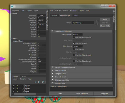

To create a floating multi-panel window
You can dock several panels together into a single floating window which you can then move around.
This is especially useful when you're setting up your editors on a second monitor. For example, you can dock the Attribute Editor and Channel Box together and keep them on another monitor to maximize the working space in the view panel.
- Open any panel or editor in a floating window, or undock it so that it is floating.
Drag another panel onto an edge of the panel in the floating window.
To create a tab deck if one does not exist yet, drag the panel to the upper-left corner of the panel in the target window until a blue triangle appears, then release the mouse button.
