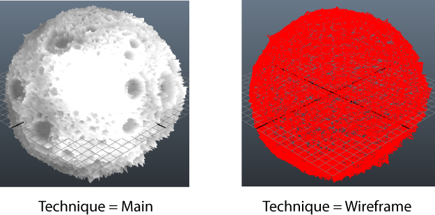

In this shader, two techniques are defined: the main technique, which displays a shaded view, and the wireframe technique, which displays a wireframe that illustrates tessellation. To set the inner levels and outer levels of the tessellation, you can adjust the Inner levels/100*100 pix (the number of inner levels in a 100 x 100 pixels area) and the Outer levels/30 pix (the number of levels for every 30 pixels segment) settings and see the effect in Viewport 2.0.
