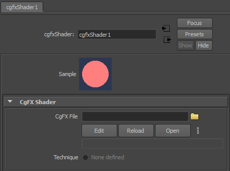

- In the
CgFX Shader section, type in the path to the
.cgfx file you want to use, or browse to the
.cgfx file.
Once the .cgfx file is connected to the CgFXShader node, the plug-in automatically loads attributes (if any exist) into the Extra Attributes section in the Attribute Editor.
- Open the Extra Attributes section, and adjust any attributes as necessary.

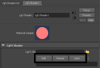

Reloading, Editing and Viewing CgFx files
In the Attribute Editor of the cgfxShader node, you can use the Reload, Edit and Open buttons to work on the FX file you’ve specified.
- Reload
Reloads the specified CgFx file from the disk.
- Edit
Opens the specified CgFx file in Microsoft® Notepad on Windows, and vi on Linux, for editing. Edit the file as required, and save it. Maya automatically reloads the CgFx file.
- Open
Opens the specified CgFx file in Notepad in read-only format on Windows, and vi on Linux.
