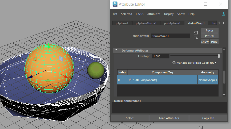

To open the Deformer Attributes for a specific deformer
- Click the <deformer type> tab in the Attribute Editor (for example, shrinkWrap1) on geometry that has a deformer assigned

Deformer Attributes section
Right-click this table for options to edit deformer falloffs. See the Deformer Attributes right-click menu section in this topic.
- Envelope
- Specifies the deformation scale factor. Values can vary from 0 to 1. Default is 1.

The Component Tags attributes are shown in table format:
- Deformer Attributes table
- Use this table to modify your falloff effects. Right-click anywhere in this table and choose Column Visibility to show or hide columns in the Input Attributes table.
- Index
- The falloff index (placement) in the array.
- Component Tag
- The Component Tag expression for the geometry to be deformed.

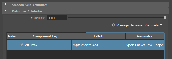

- Falloff
- Name of the deformer falloff effect to be blended.
- There are five falloff types, each with their own settings. Click the link to the related falloff attributes in the following table for specific information:

See Transfer Falloff attributes . - Geometry
- The name of the geometry to which the deformer falloff is applied.

Deformer Attributes contextual menu
Right-click in the Deformer Attributes table to expose a menu where you can add, edit, or convert deformer Falloff effects.
