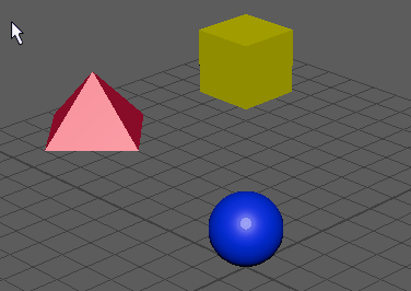

Parent constraints let you relate the positionof one object to another, so that they behave as if part of a parent-child relationship that has multiple target parents. See Parent constraints for more information about using Parent constraints.
To create a parent constraint
- Select one or more target objects, followed by the object you want to constrain.
