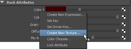

- In the texture’s
Attribute Editor, place the cursor over one of the
Color attributes then right-click
Create New Texture from the pop-up menu.

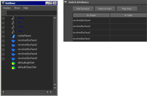

- Open the
Outliner, and middle-drag the objects for which you want to display another texture into the
inShape column.
Only four of the bowls in the following are to be texture mapped. The top bowl retains the Default color setting.

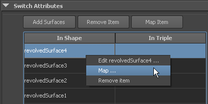

- To map textures to the other objects, click to highlight the revolved surfaces in the
inShape column then select the
Map Item button.
- Select another texture for each object from the
Create Render Node window.

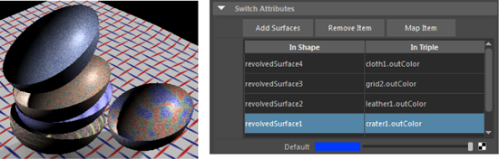

The following shows the four bowls and the textures mapped to them in the Switch Attributes editor.

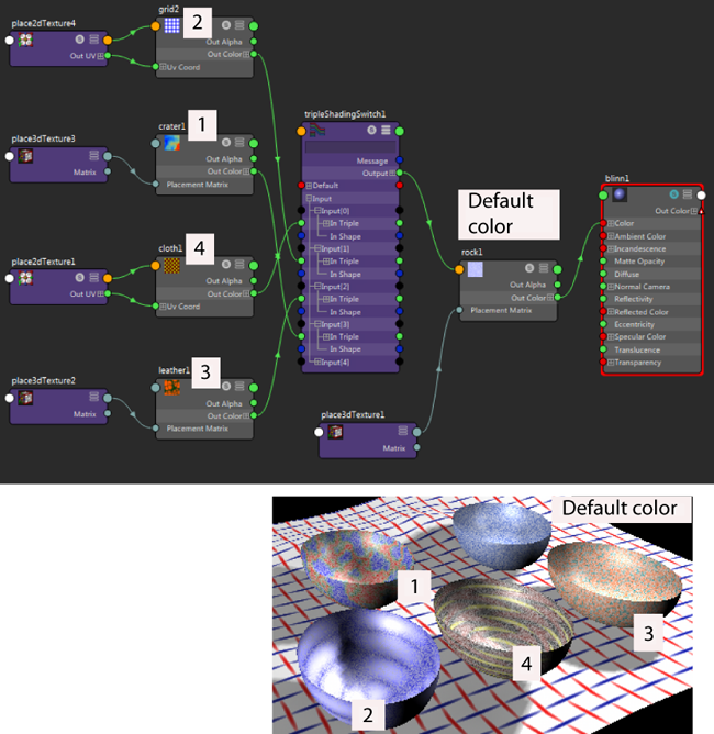

Adjust the textures for each item if necessary. The following gives you a better idea of how the textures are mapped to the bowls and how the connections display in the Hypershade.
