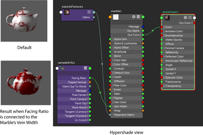

- Connect any of the SamplerInfo node output attributes to any of the texture input attributes. Experiment with different connections and preview the results in the Material Viewer.
In this first example, the SamplerInfo’s Facing Ratio attribute is connected to the Marble texture’s Vein Width.

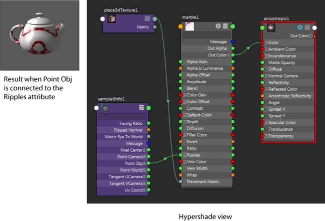

In the following example, the SamplerInfo’s Point Obj attribute is connected to the Marble texture’s Ripples attribute.
