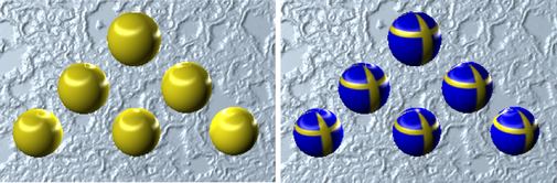

  5. Select the Double Switch utility from Maya > Utilities in the Create Render Node window. Notice that the spheres seem to have lost their textures.
    This is when you can apply a Default setting in the doubleShadingSwitch Property Editor. You can either map a new texture, or change the values for U and V. In the following the Default value is changed to 1.5 for both U and V.

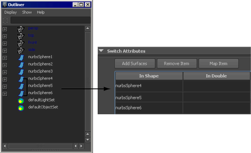

  6. In the Outliner, use the middle mouse button to select the spheres for which you want to adjust the UV texture placement and drag them to the In Shape column of the Switch Attributes section of the doubleShadingSwitch Property Editor.
    Notice only the spheres you move into the In Shape column lose their textures. These are the spheres you want to change.

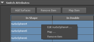

  7. Shift-select all the rows in the inShape column, and then right-click and select Map.

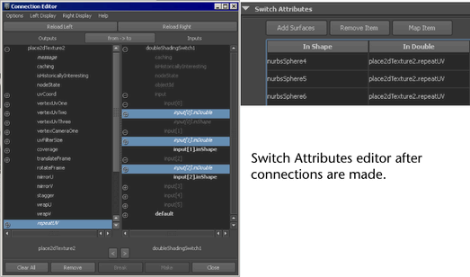

  8. Select the 2d Placement utility from Maya > Utilities in the Create Render Node window. The Connection Editor appears. Click the Repeat UV Output attribute (in the left column), then, in the right column, expand input[0] and select input[0].in Double. Select also input[1].inDouble, input[2].inDouble, and so forth depending on the number of spheres you are mapping.
    Only the spheres you mapped in the Double Shading Switch’s Property Editor update. Click the place2dTexture swatch in Hypershade to open its Property Editor and adjust the Repeat UV values if necessary. A higher Repeat UV value makes the grid pattern more dense.
