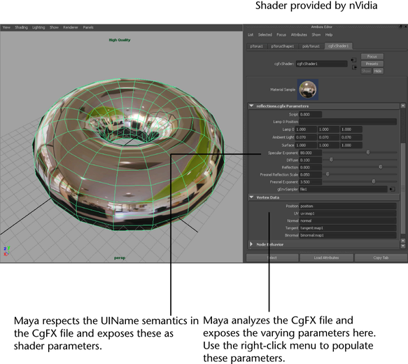

Customizing the CgFX shader
You can use the MAYA_CGFX macro to customize your CgFX shaders to include Maya specific attribute annotations without breaking the compatibility with other applications that might also use the same CgFX shader.
For example, you can use the following code to declare the directional light attribute in both Maya and another application without causing any compatibility issues:
#if defined(MAYA_CGFX) || defined(XSI)
// Declares the « dirlight0 » with attribute annotations for Maya or XSI
float4 dirlight0 : Direction <
string UIName = "Distant Light 0 Direction";
string Object = "DirectionalLight";
string Space = "World";
> = {-1.0f, -1.0f, 0.3f, 0.0f};
#else
// Declares the « dirlight0 » with attribute annotations for another application:
#endif
The lines between #if defined(MAYA_CGFX) || defined(XSI) and #else are only parsed when loaded by Maya/XSI.
