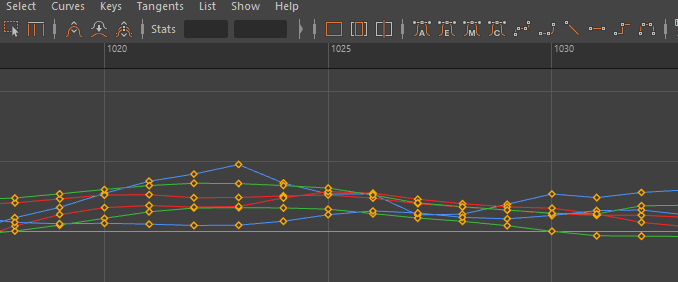

- Prefer Selected Curves
- Activate this option to limit the selection of keys or tangents to the curve you are working on. When this setting is active, if you drag-select over a group of curves, only the keys on the selected curve are selected. This helps prevent accidental key selection when working with dense animation data.
- This setting is off by default.

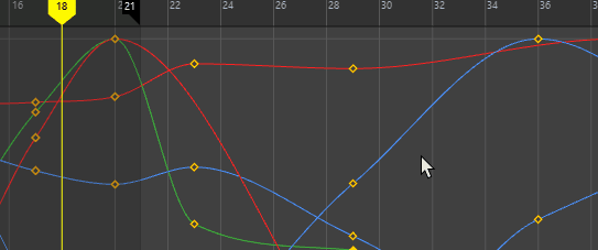

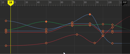

Prefer Selected Curves lets you focus on a chosen curve
- Snap Time to Selection
When this option is on, the current time marker snaps to any key you select. Hotkey: Alt + / (forward slash)
Compared behavior between Snap Time to Selection off, followed by on
