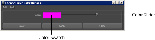

- Change Curve Color >
Opens the Change Curve Color Options window. This window lets you create custom curve colors for the animation curves selected in the graph view.
You can also create custom curve colors for your animation curves from the Attribute Editor or through MEL. See Change animation curve colors through the Attribute Editor or with MEL
You can change the default colors for items in the Graph Editor in the Colors settings Graph Editor area.
- Color Swatch and Color Slider
Clicking on the Color Swatch launches the Maya Color Chooser. The Maya Color Chooser lets you select a new custom color for your curves.
Dragging the Color Slider increases or decreases the value of the color represented by the Color Swatch.
- Color
Applies the current swatch color to the animation curves selected in the graph view and closes the Change Curve Color Options window.
- Apply
Applies the current swatch color to the animation curves selected in the graph view. The Change Curve Color Options window remains open.
- Close
Cancels the Change Curve Color operation and closes the Change Curve Color Options window.
