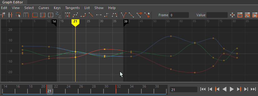

- Show Play Range Shades
Turn this on to display the Play Range Shades in the Graph Editor.
Tip: You can change the color and opacity of the Graph Editor Play Range Shade in the Color Settings . See also Graph Editor Colors.See Graph Editor Play Range Shades in the Graph Editor Graph view topic for more.
- Lock Play Range Shades
- Turn this on so the Graph Editor Play Range Shades cannot be dragged. This prevents you from accidentally moving the Play Range Shades when moving the Current Time Marker to scrub the time. You can still change the Playback range with the Range slider when this setting is active, but you cannot drag the Play Range Shades in the Graph Editor.
- This setting is off by default.

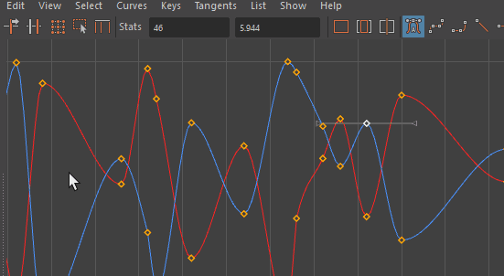

- Highlight Affected Curves
Highlights the curve segment that is affected by the selected key/tangent. When selecting a key or tangent, the part of the curve affected by the selected key/tangent is highlighted in white.
- If you:
- Select a key: the affected curve highlights each side of the key
- Select multiple keys: the entire range of the curve affected by the selection is highlighted
- Select a tangent: the segment of the curve affected by the selected tangent (on the selected side) is highlighted
- Select multiple tangents: highlights only parts affected by the selected tangents

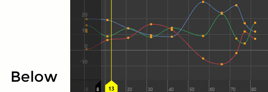

Infinity turns on or off the display of the animation curve extrapolated outside the first and last keys of the curve.
The curves before the first key and after the last key will be constant by default.Note: This option is on by default as of Maya 2025.3. In previous versions, the Infinity option was off by default.

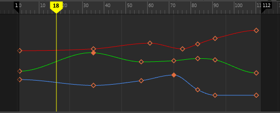

- Stacked View
Note: Formerly known as Stacked Curves in Maya's Legacy Graph editor. In an effort to simplify the Stacked View, there is no coloring of the "swim lanes", fewer vertical (time) grid lines, and time values are displayed at the top of the graph.
- Press 2 to activate Stacked View.
When on, the graph view displays individual curves in a stack, rather than displaying all curves overlapping. When Stacked View is active, each curve displays with its own value axis, normalized between 1 and -1 by default.
Attention:When using the Scale Keys Tool or the Lattice Deformer Keys Tool with the Stacked View active, you can only modify the time value.
- You can modify the horizontal lane spacing in the Graph Editor settings in the Animation (Settings) preferences.

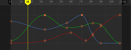

- Normalized View
Note: Known as Display Normalized in the Graph editor. - Press 3 to activate Normalized View.
When on, this option scales down large key values or scales up small key values to fit within a -1 to 1 range. When animation curves are normalized, they are adjusted to fit within the range of normalization.
Curve normalization is useful when you want to view, compare, or edit animation curves that are related (such as rotation and translation curves), but have drastically different ranges. For example, with curve normalization you can compare all the translation and rotation animation curves for an object.
When you turn Display Normalized off, the curves revert to a non-normalized state, back to their original ranges.
Note:Animation curves that are normalized appear thicker than other curves in the Graph Editor.

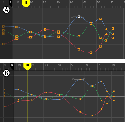

- Key View
Lets you switch between the default
Detailed Key View (A) and
Simplified Key View (B)
Key View: A Detailed, and B simplified
- Detailed key view
- The Graph Editor default view, Detailed key view, gives you visual cues about keys and tangents, such as showing filled or hollow keys that show whether a key has been edited or is automatic or identifying the type of curve. This feedback provides a quick way to identify the state of the animation you're working with.
- Simplified key view
- Simplified key view contains less visual information on the keys.
- If you want to simplify your view to show only the key you're working on, or the curves without keys, see Keys, above, and change the setting to Active.
