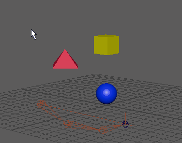

A pole vector constraint causes the end of a pole vector to move to and follow the position of an object, or the average position of several objects. For more information on pole vector constraints, see Pole ector constraints. For more information on pole vector constraints, see Pole vector constraints.

  1. Select one or more target objects, followed by the IK rotate plane handle whose pole vector you want to constrain.
