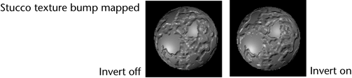

Invert
Reverses all texture colors (black becomes white, white becomes black, and so on). Invert is off by default. For example, you can change a bump or displacement map’s raised regions to depressions and vice versa by setting Invert on or off.
