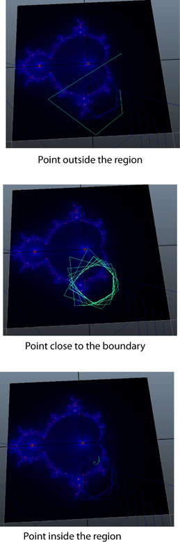

The Mandelbrot (and its related sets) evaluations are based on iteration. It represents the region of the complex plane zn+1 = zn2 + c, where you start with z0 = 0 and iterate repeatedly while the absolute value of zn remains bounded.
In other words, if you have a point in UV space, and you want to determine if the point is inside the region or not, you iterate the function at that point (that is, take the output of the function and apply the function again repeatedly) and examine its value. If the value stays within the escape radius, regardless of the number of iterations, it is in the region. Otherwise, if the value exceeds the escape radius, it is outside of the region.
The image below illustrates the different behavior of the iterations depending on where the point is in UV space. If the point is close to the boundary of the region, many iterations are performed and form a repeating pattern, but they stay within a fixed distance of the origin. However, when the point is inside or outside the region, the iterations produce very simple curves.
You can choose among several shading methods. If you shaded based only on whether a point is in or out of the region, you have only a flat two color texture. Instead, you can base the color on how quickly the function escapes or settles (in other words, the number of iterations performed). Other methods include evaluating the path (or orbit) that the point follows in UV space while iterating, and using different properties of this path to map a color to the point (for example, evaluating how close the path comes to the origin, or the U or V axis).

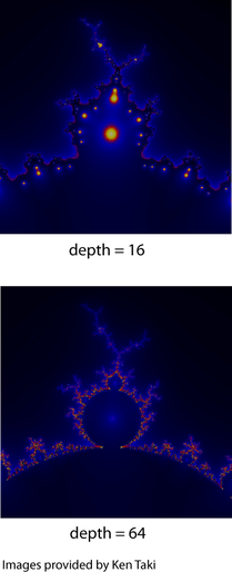

- Depth
- Use this attribute to determine the amount of calculations performed to create the Mandelbrot texture. Fractal textures are created by an iterative mathematical process. More iterations produce a more detailed fractal, but demands more calculation time. The higher the
Depth value, the better one can resolve the border region of the Mandelbrot set. As you zoom into the fractal, a higher
Depth value is required for better precision and detail.

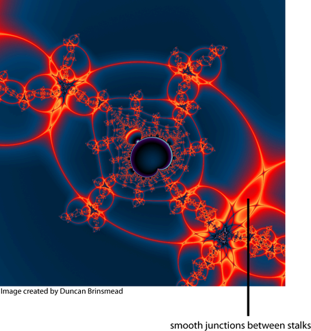

- Line Blending
- This attribute creates smooth junctions between circles, points and stalks. You may need to increase the focus when adjusting this effect.

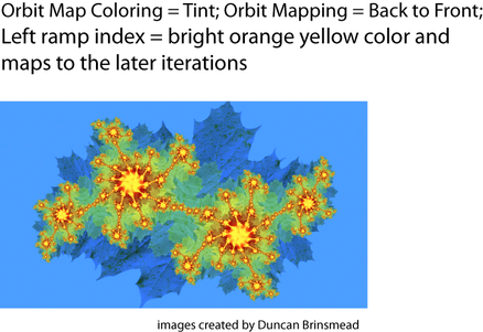

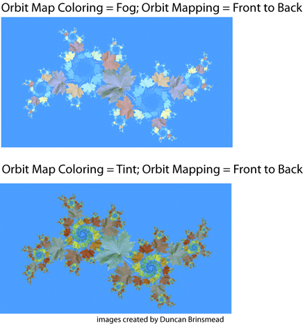

- Orbit Map (only for Mandelbrot 2D node)
- Use this feature to map a texture to the local space of each iteration of the set. You should use textures with an alpha and turn off UV wrapping on the texture that is mapped. If you use UV wrapping then you should set the coverage to less than 1 and use translate to center the map. In addition, you can use the Line Offset U and Line Offset V values to better position the texture.
- Orbit Mapping
- Off: no texturing.
- Front to Back: Orbit map is used and earlier iterations appear in front.
- Back to Front: Orbit map is used and later iterations appear in front.
Note: When using Front to Back mapping, a large Escape Radius may cause early iterations (large images in the front) to obscure the later iterations (smaller images at the back). This is not an issue, however, for Back to Front mapping, because the small, detailed images (late iterations) are in front. You can therefore use a high Escape Radius with Back to Front mapping. The Tint Orbit Map Coloring method may be useful for providing contrast to better see the fine details of the later iterations. See Escape Radius for more information. - Orbit Map Coloring
Orbit map coloring allows you to color the orbit texture based on the iteration depth.
- Fog: Gradually blends to color ramp values. If you use Front to Back mapping, the earlier iterations (larger images) appear in front and maps to the texture color. The later iterations (smaller images) appear at the back and maps to the right ramp index. If you use Back to Front mapping, the earlier iterations (larger images) appear at the back and map to the right ramp index. The later iterations (smaller images) appear at the front and map to the left ramp index.
- Tint: Multiplies the color of the texture by the ramp color. For light tinting, select ramp colors close to white.
