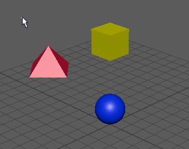

Create a scale constraint
Scale constraints let you match the scaling of one object to one or more other objects. This constraint is useful for making several objects scale simultaneously. For more information, see Scale constraints.
When creating scale constraints, you can first set creation options and then create a scale constraint, or you can immediately create a constraint with the current creation options. See Scale constraint options.
To create a scale constraint
  1. Select one or more target objects, followed by the object you want to constrain to them.
  2. Select Constrain > Scale.
