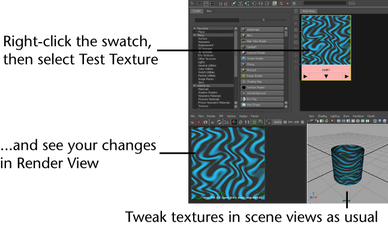

To test a texture on any native Maya rendering node
- In
Hypershade, do one of the following:
- Right-click a render node, then select Test Texture.
- Select the texture, then select Edit > Test Texture.
- If you want to change the resolution first, select the texture, then select
Edit > Test Texture >
to display the options. For descriptions of the options, see
A sample image is rendered in Render View.
- To save the tested image, in Render View, select File > Save Image.
