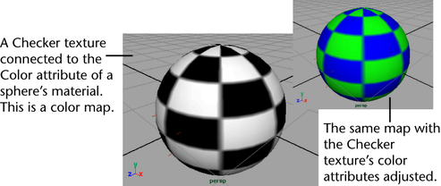

For example, if you connect Maya’s 2D black and white Checker texture to the color attribute of an object’s material, you have applied a color map; the checkered pattern determines which parts of the object appear black and which appear white (or other colors if you adjust the texture’s color attributes).

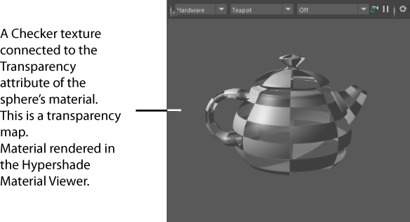

If you connect the black and white Checker texture to the transparency attribute, you have applied a transparency map; the checkered pattern determines which parts of the object are opaque and which are transparent.

By mapping a texture to the Color attribute of an object’s material, you create a color map which describes the color of the object.
