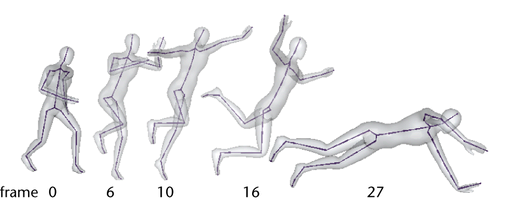

- Load a sequence of motion capture data into your scene.
This example describes a scene with motion capture data plotted to a biped skeleton.
In this example animation, the wrist makes contact with the floor at frame 27, but the position of the hand is shaky and unnatural. We want the hand to hit the floor at frame 27, then stay steadily planted between frame 27 and 40. You can modify the animation between those frames to stabilize the hand as it makes contact with the floor.

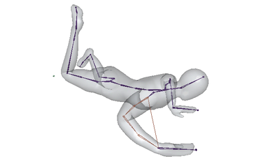

- Insert a single chain solver between the shoulder and wrist by doing the following:
- Select
Skeleton > IK Handle Tool >
from the main menu bar.
- Select the shoulder as the start joint, then select the wrist as the end joint. (See also Create IK handles.)
- In the IK Handle Settings, select Single-Chain Solver as the Current solver.
Note:This example uses a single chain IK solver, but you can also use the effector on a HumanIK rig to achieve the same results.
In the next steps, you’ll use the IK handle as an effector to manipulate the position of the wrist.
