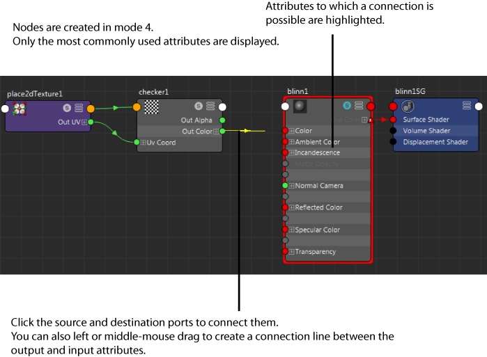

By default, when you first create a node in the Hypershade, its most commonly used attributes are displayed (hotkey 4 mode in the Node Editor).

To connect attributes using connection lines
- Click the source and then the destination ports to connect them.
Alternatively, you can left or middle-mouse drag to create connection lines between your output and input attributes. To release a connection line, left click on any empty area of the graph, or press Esc.
As you mouse over the available inputs, all inputs that can receive the connection are highlighted. This indicates that it is possible to make a connection with this input.
All inputs that cannot receive a connection are greyed out. This indicates that a connection is not possible.
If you mouse over a compound attribute, the Hypershade automatically expands to expose its children to which you can make a connection.
In addition, it also snaps to the ports to which you can make a connection. This allows you to easily identify the attributes that you can connect to.
