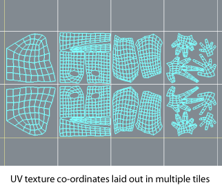

You can paint on a model that contains UV texture coordinates that have been positioned outside the default 0-1 UV texture range.
This lets you take advantage of greater image resolution in your painted maps than if the UVs were positioned only within the 0 to 1 range. Mudbox creates an image map for each tile region at the resolution you specify for the paint layer.
UVs must be explicitly laid out in a tiled configuration using your 3D modeling or UV editing application. For more information on how UV tiles work, see UVs overview.
Mudbox automatically keeps track of each image file associated with a UV tile and automatically bleeds the paint along the UV shell borders to ensure there are no seams. For best results, see Prepare a model for painting.

When UVs exist in multiple tile regions for a model, a texture map is created for each UV tile at the resolution and format you specify for the paint layer. That is, if a model contains UVs that exist in four UV tile regions (for example, u1-v1, u2-v1, u3-v1, u4-v1), four texture maps are created for each layer when the file is saved. These texture maps are saved with a unique file name in the files texture directory associated with the Mudbox file and are loaded when you open the scene in Mudbox. Files are named as follows: <image>_u1_v1.tif, <image>_u1_v2.tif, and so on, where <image> is the name of the associated paint layer).
