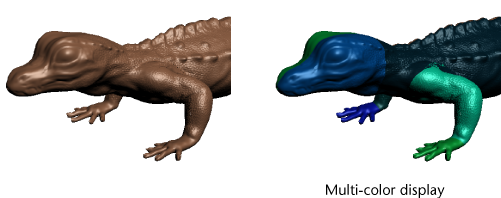

Randomly coloring the unloaded tiles lets you determine:
- Mudbox is currently optimizing the display of the tiles to save video memory. It also indicates that multiple tiles exist on the model.
- The location of each texture tile on the model in relation to one another and which parts of a model are assigned to particular tiles.
- Which texture tiles are currently loaded or unloaded on the model so you can selectively load or unload any texture tile(s) when painting as required.
