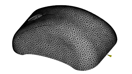

Import the part
  1. Click Import (Home tab > Import panel > Import).
  2. Navigate to the location where you saved the tutorial file.
  3. Select the file mousecover_meshed.sdy and click Open.
    Imported mouse cover
