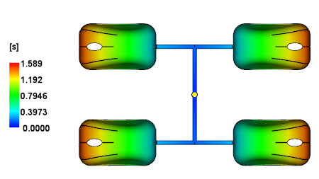

In this task, you review the Fill time result.
Click the Fill time result in the Study Tasks list.
Click
(Results tab > Animate panel > Play).
Rotate, pan, and zoom as necessary to see the filling pattern.
The filling pattern is uniform between the four parts.
