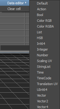

Data Types
There are 19 data types shown in the Data editor:
Expression constraint data types
The following table lists and describes each expression constraint data type.
Data TypeDescription
DefaultDefault numerical value expressed as 0.00. Vectors and colors are expressed as {0.00,0.00,0.00,0.00}.
Action
BoolBoolean value (represented by a check box) data type. This value is true (1.00) when the box is checked, and false (0.00) when it is not.
Color RGBRGB color vector value. Each coordinate has its data cell that shows the coordinate’s color. Each coordinate holds a decimal value between 0 and 1.
Color RGBARGBA color vector value. Similar to the Color data type, but with an additional data cell for the alpha channel.
List
HSBInt64
Int64
Integer
Number0.00 value. When switching from vectors and colors, the new number cell takes the first coordinate.
Scaling UV
StringList
Time
Time CodeTtime code value (000:00:00:00 (00)).
Translation UV
UInt64
VectorX, Y, Z vector value. Each coordinate has its data cell. When switching from a number cell, the number is placed in the vector’s first coordinate.
Vector2
Vector4
