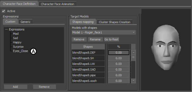

Custom pane
Use the Custom pane in the Expressions area to define your own custom expressions. Custom expressions can be whatever facial expressions your project requires, including expressions that represent phonemes and are linked to the Voice device.
Character Face Settings A. Custom Expressions pane
For example, you can create an expression, such as a surprised face, from a blend of shapes for the eyes, mouth, eyebrows, and other shapes.

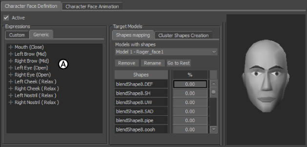

Generic pane
The Generic pane in the Expressions area displays a basic set of facial expressions used to connect the Character Face with an Actor Face.
Character Face Settings A. Generic pane
An Actor Face lets you connect the Character Face to motion capture data from either a live source or imported file.
